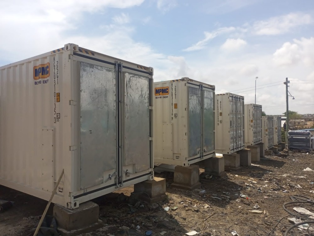

      Delivered projects show the higher class is available rather than default: a Mexican stadium installation is listed with C-5 painting, and a Brazilian offshore project at 10.28 MW is listed as containerised for marine deployment. On a project with coastal and inland positions, different classes for different positions is usually the correct answer rather than one class for the contract.
      MPMC containerised generator sets — powered by Cummins
